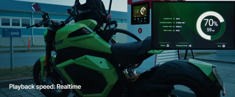

Image of a Verge TS Pro bike attached to a fast charger as part of Donut Lab's I Donut Believe series.
Donut Labs (YouTube)
Even to a non-expert, there’s clearly a gap between what Donut promised and what its tests are showing. For instance, the company said it would be able to fast charge a Verge TS to full in less than 10 minutes. But, in Test Four, it took 12 minutes to get from 9 percent to 80 percent — not a bad charging time, but certainly not as swift as the company pledged. That said, if we take the company’s claims at face value, then being able to fast charge a battery at that sort of speed with just air cooling is noteworthy. At least, it will be if you can do that regularly, and one or two trips to the charger don’t leave you with what Reddit likes to call a Spicy Pillow afterward.
