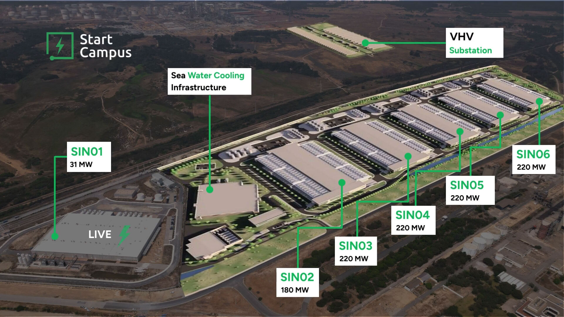

A map of Start Campus
Start Campus
Start Campus, a data center project in Portugal, is located on the site of an old coal-fired power station and will use much of its old infrastructure. Rather than simply employ a closed-loop, the high temperatures will require the closed-loop system to interact with an open loop. When the campus is fully operational, its heat will be passed onto around 1.4 million cubic tons of seawater per day. Omer Wilson, CMO at Start Campus, said that by the time the water has returned to its source, its temperature will be the same as the surrounding sea. Start Campus has also pledged that there will be no meaningful water loss from this process.
Start Campus
