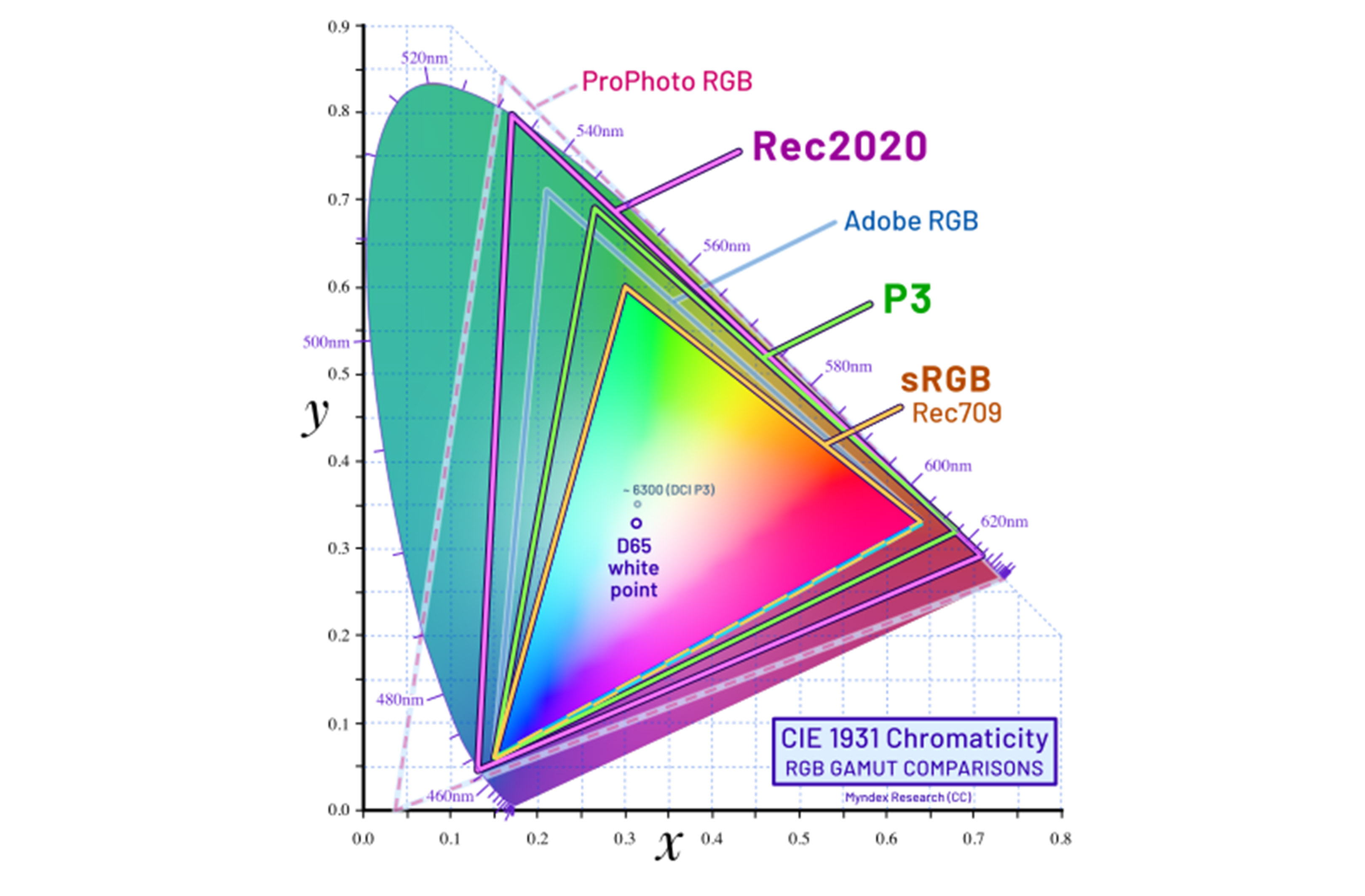

Before talking about Micro RGB, let’s look at color space and gamut both for HDR, which uses the BT.2020 standard, and SDR, commonly associated with the REC.709 standard. REC.709 is ideal for regular HD content like TV broadcasts and YouTube videos. It can display a limited set of colors and brightness is generally capped at 100 nits.
BT.2020, however, is designed for high-end HDR streaming and 4K or 8K content creation (via Dolby Vision, HDR 10 or HDR10+). It has a much wider color gamut, meaning it can display a wider variety of colors and a bigger chunk of the visible color spectrum. It’s also designed for significantly higher brightness levels of 1,000 nits or more.
To achieve the color accuracy required for BT.2020, TVs must have extremely accurate red, green and blue pixels. Up until last year, the most color-accurate TVs used quantum dot technology and achieved a maximum of around 85 percent BT.2020 coverage (some projectors can cover 100 percent or more of the BT.2020 spectrum as they use RGB lasers to create colors).
