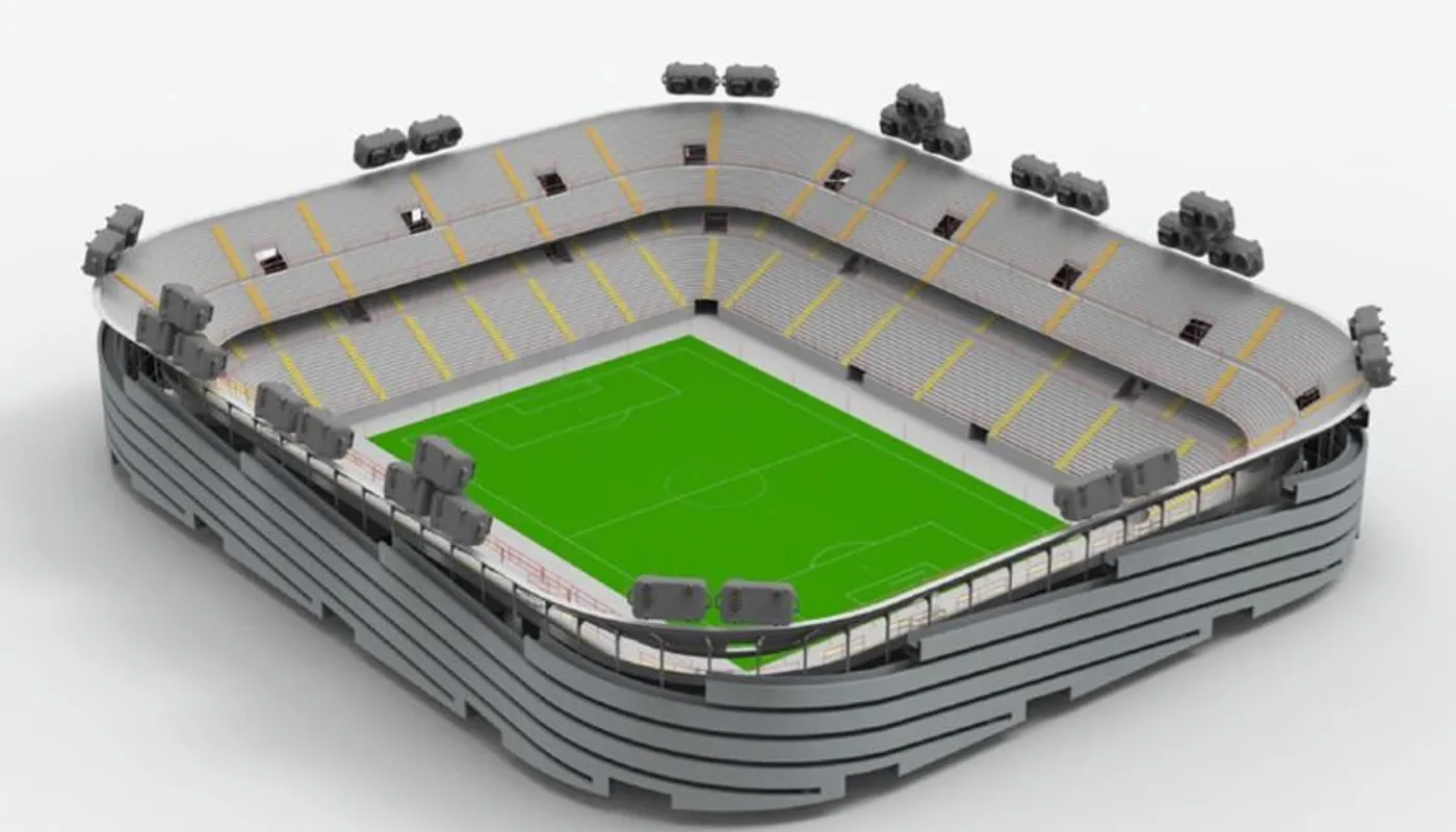

SAOT uses sensors from up to 30 cameras mounted high above the field in each Premier League stadium. They track the ball's precise location and up to 10,000 surface data points for each player. The sports tech company Genius Sports explains that the tech "provides more efficient placement of the virtual offside line, using optical player tracking, and generates virtual graphics to ensure an enhanced in-stadium and broadcast experience for fans."
Render of a Premier League stadium with cameras mounted around the upper bleachers.

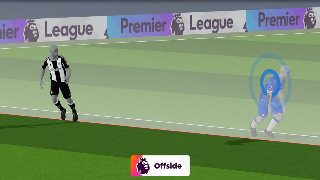

SAOT cuts a big chunk out of this (often lengthy) process by suggesting the kick-point and automatically creating offside lines based on the relevant defender and attacker's positions. The VAR team still has a chance to review the algorithm's suggestion before approving it.
At that point, a "decision visual" like the one below will roll for the fans in the stadium and those watching the broadcast at home to help clarify the call. The animation shows a white vertical wall representing the offside line, with a red (offside) or green (onside) line indicating whether the player crossed it.
Example of a decision visual from the Premier League's SAOT.
This SAOT decision visual shows the attacker's right arm crossing the offside line.

VAR will still be available as a backup for offside calls. "Most offside decisions will be quicker, but VAR will still have the option to draw crosshairs as a backup to the SAOT system if required," the Premier League explained. "This process may be necessary in 'edge cases' where several players block the view of the ball or other players for the system's cameras."
