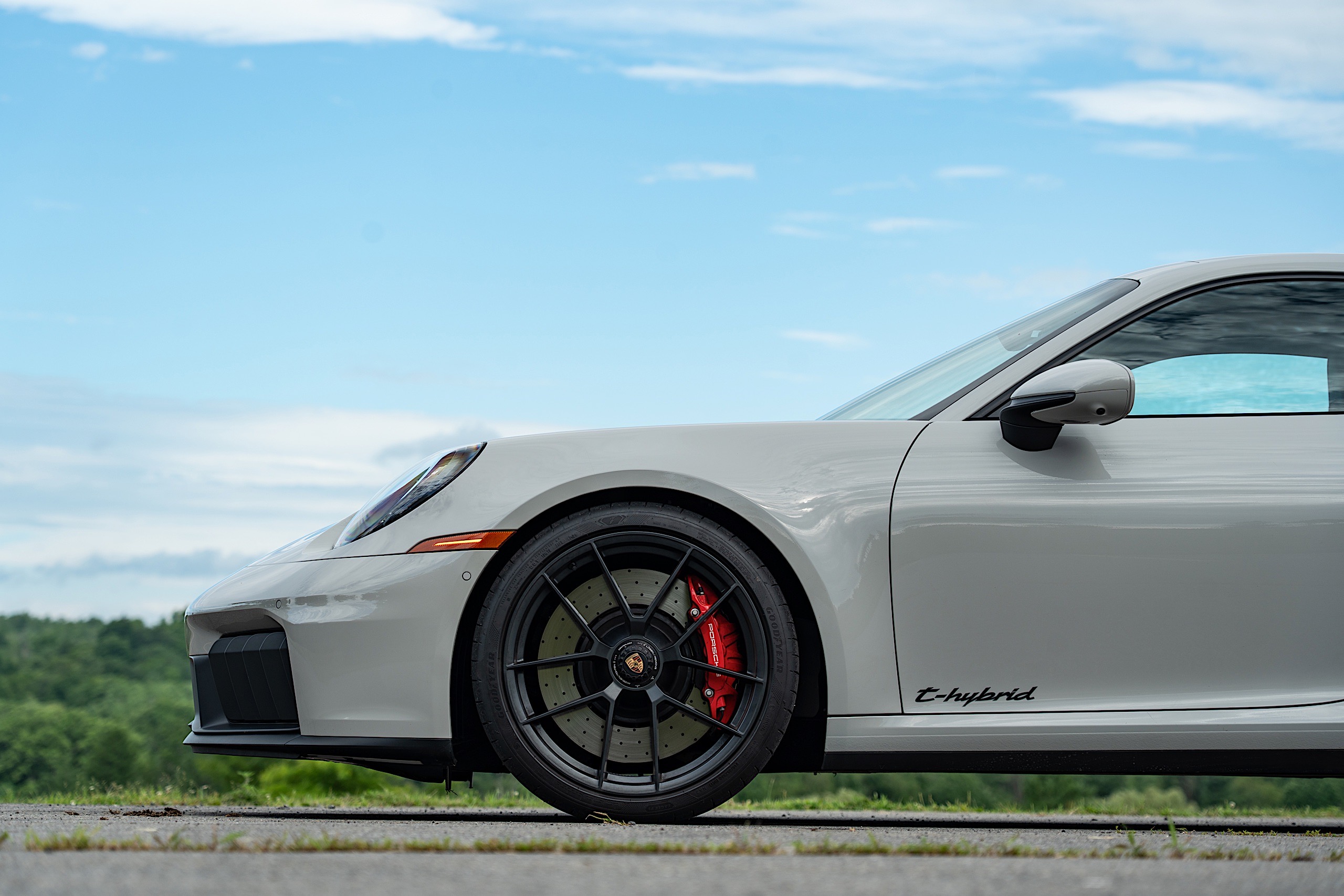

Porsche calls that whole system, plus the 1.9-kWh battery that powers it, T-Hybrid. The net result in the 2025 911 GTS is 532 hp and 449 lb-ft of torque. That's a substantial, 59-hp boost over the old GTS.
Yet the only obvious sign that there's anything different about this car is the subtle T-Hybrid badges mounted down low on the doors. And that's a good thing, because I'm of the opinion that the current-generation 911, internally called the 992.2, is one of the prettiest cars on the road. Even in this decidedly understated Chalk color, it is absolutely striking. The color pairs perfectly with the 20-inch front and 21-inch rear black wheels and other ebony highlights around the car.

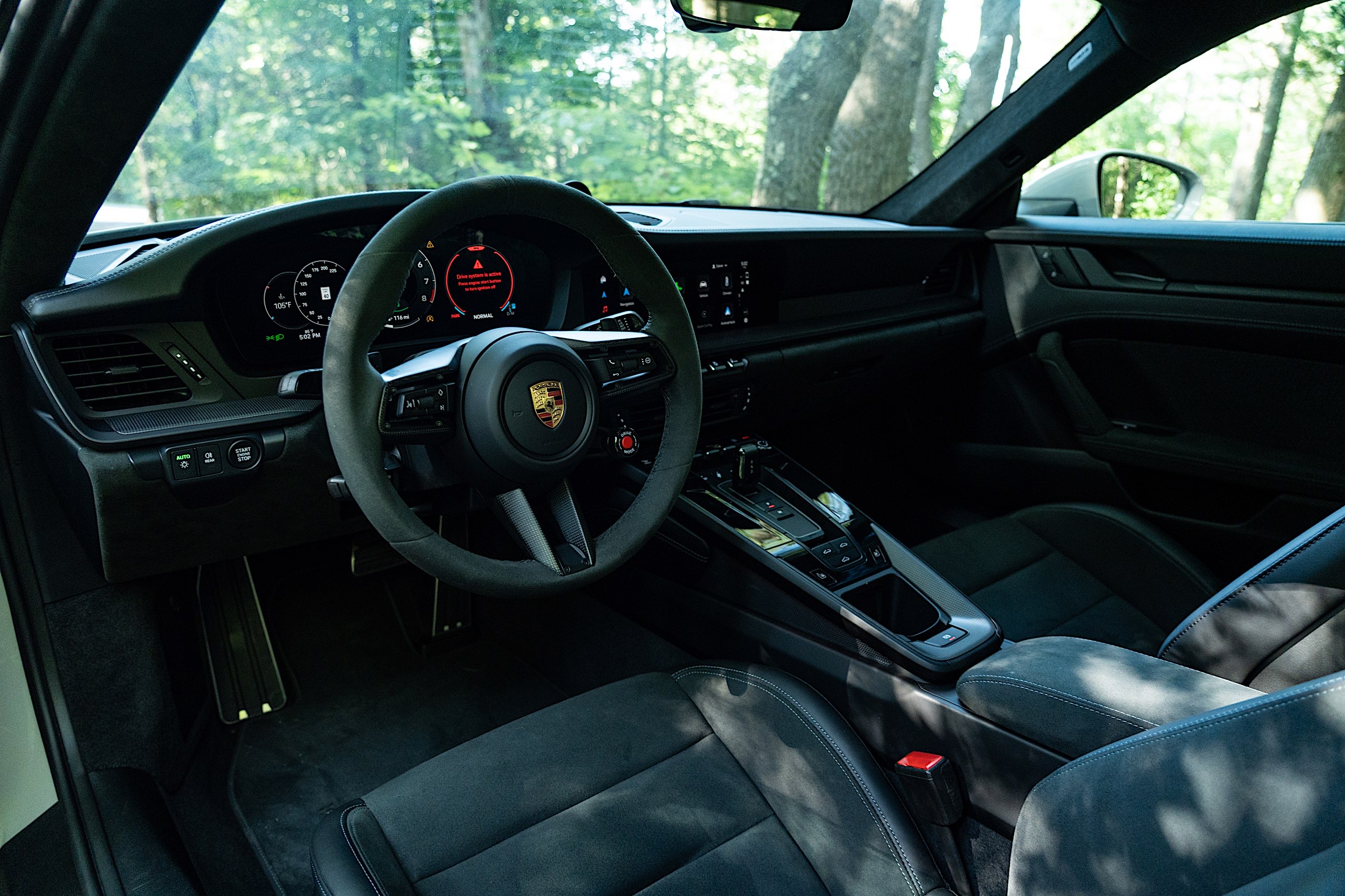

The interior is similarly minimalist, monotone to an extreme. But there are just enough subtle highlights of materials like carbon fiber and Alcantara to make it feel racy and purposeful, not basic. And, if you like, you can go with many more wild interior combinations. Porsche is happy to let you customize to your heart's content, but beware that it's going to cost you.
The car's interface is simpler than 911s of yore, too. Most of the controls have been consumed by the car's petite 10.9-inch touchscreen, serving both wireless Android Auto and Apple CarPlay, while a curved, 12.6-inch virtual gauge cluster lives behind the steering wheel. What physical controls remain are well positioned, delivering strong tactility for your frequent tasks. Perhaps the most important is the drive mode dial that’s mounted at the four o'clock position on the steering wheel. It's how you dial up the intensity of the 911 GTS. Or, push the shiny little red button to go fully manic.
