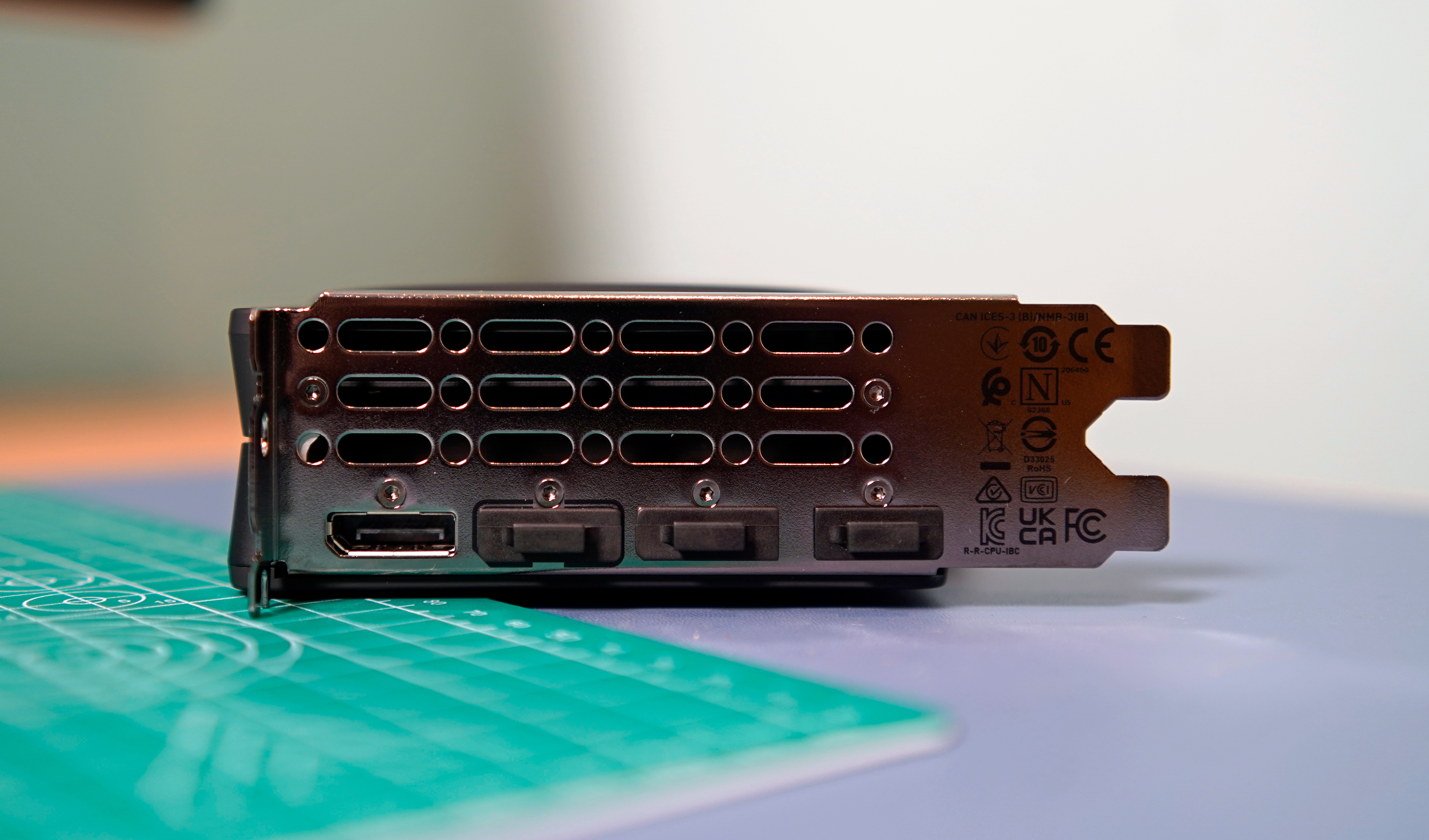

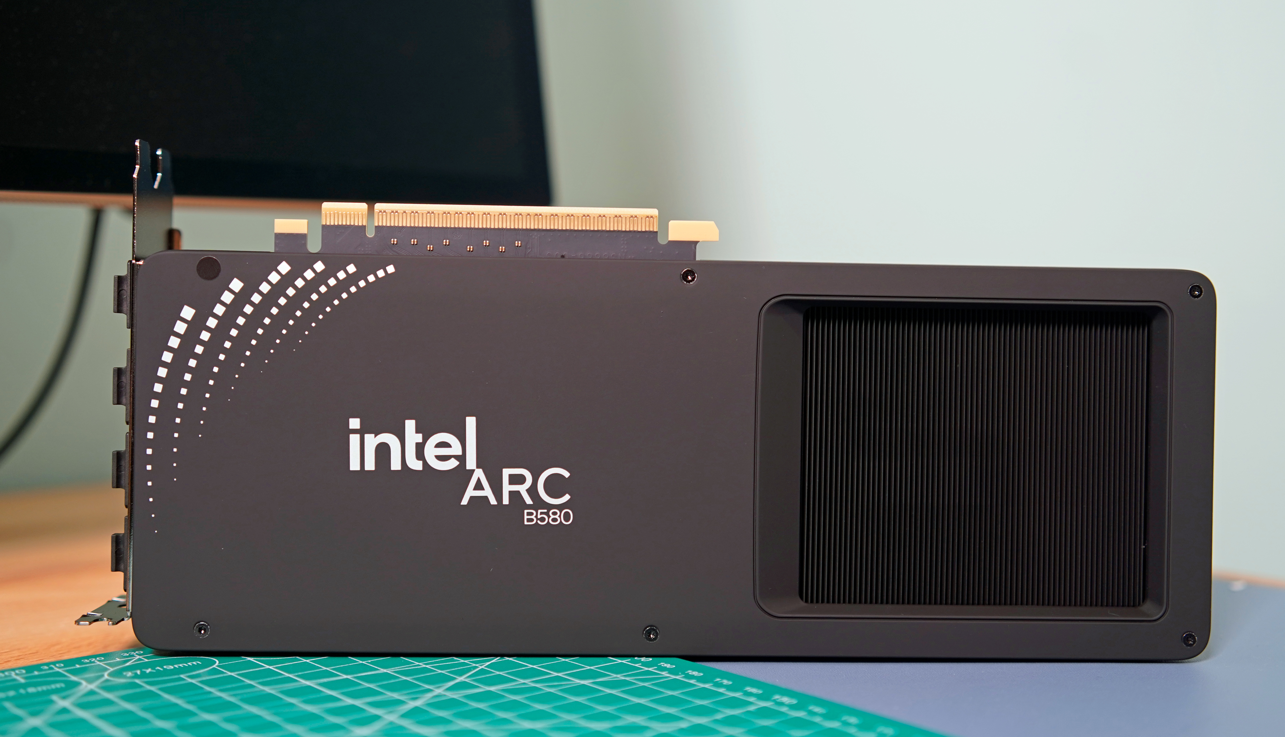

The Arc B580 also survived several hours of benchmarking and gaming without any hardware or driver issues. When I first tested the Arc A750 and A770, they would often crash within an hour of testing. Intel's software has clearly made some progress. The B580 reference model I tested also stayed relatively cool under load, and it never surpassed 64 degrees celsius (which also kept its two large fans from ever making much noise). While there will be third-party cards available, I was also impressed by Intel’s reference design: The B580 feels premium and sturdy, not cheap and plasticky like many other budget GPUs.
