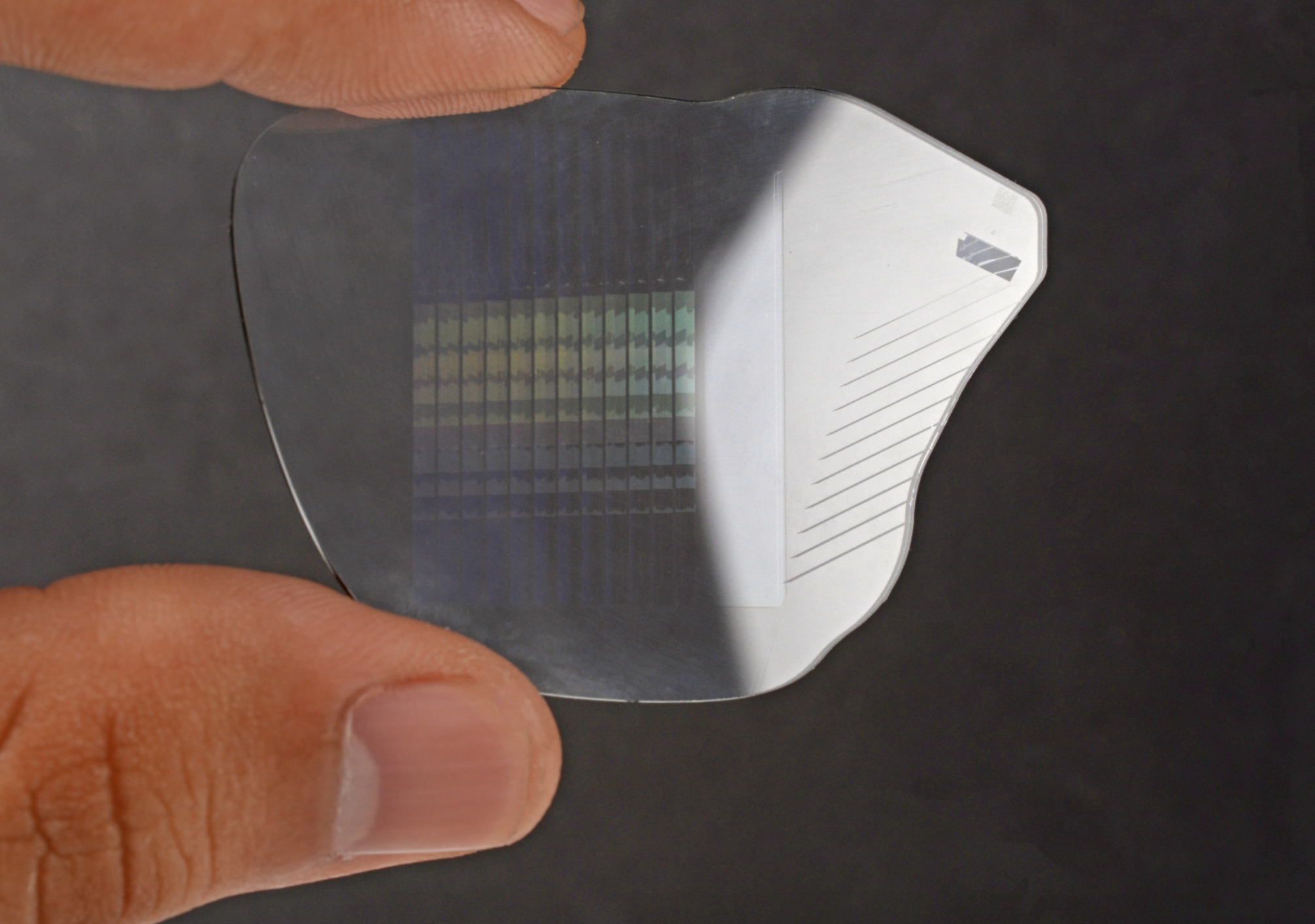

The same goes when looking to replace the lenses, as they are specially-made and would be difficult to source. However, iFixit did come away impressed with the glassmaking skills used to manufacture these lenses.
The lenses use a reflective geometric waveguide system that bounce light to the wearer's eyes at specific angles using partially reflective mirrors. This not only creates an augmented reality experience but helps prevent other people from getting a glimpse of the screen when staring at you.
