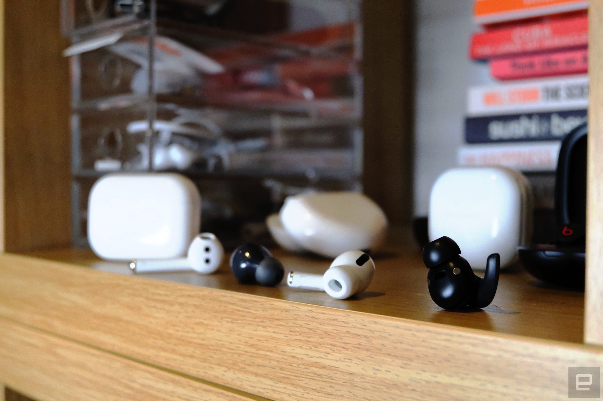

The cleaning process differs depending on what kind of buds you have. First, there are wireless earbuds with removable silicone (or plastic) buds, like Samsung's Galaxy Buds, Sony’s WF-1000XM5 buds or most Beats buds, and several models with a single solid body, like Apple’s AirPods.
The main difference is that the detachable tips are easier to deep clean. They are also replaceable and spare tips often come in-box. You can also use soapy water or other mild cleaning products on particularly messy tips without fear of damaging the electrical parts of your headphones.
Wipe down the earbuds and removable tips with a microfiber cloth. As most wireless buds are stored in a case, you may find that dirt from the tips has shifted to the headphones, too. Apple says you can use “70-percent isopropyl alcohol wipe, 75-percent ethyl alcohol wipe or disinfectant wipes” to clean the exterior of its wireless headphones, but advises that you shouldn’t use wet wipes on the speaker mesh parts of the AirPods. Samsung’s guidance sticks to soft dry cloths and cotton swabs.
Remove the tips, and gently trace the inside of each bud with cotton swab, or a toothpick if you need something thinner. If any detritus sticks around, upgrade to a metal loop on the end of an earphone cleaning tool, but just go carefully. Metallic objects are more likely to scratch and pierce things. The cleaning tool also has a brush at the other end to pull out any loose dirt. Once clear, wipe the sides of the tips with a slightly damp cloth.
The AirPods Pro tips each have a delicate mesh membrane, making it easier to clean than membranes on the headphones themselves, but they’re also fragile. Apple itself advises that you can rinse the tips with water, adding you shouldn’t use soap or other cleaning products on them. If you do use a damp cloth or rinse them, make sure to set them on a dry cloth and let them dry completely before reattaching them.
Apple advises using cotton swabs or a dry cloth for the microphone and speaker mesh parts of the AirPods. You can also use a bulb air blower, which should provide a mild amount of force to dislodge dirt without harming electrics. However, while it might be stronger, don’t use canned air. Sony says this can force dust further into the microphone or sound outlet holes.
