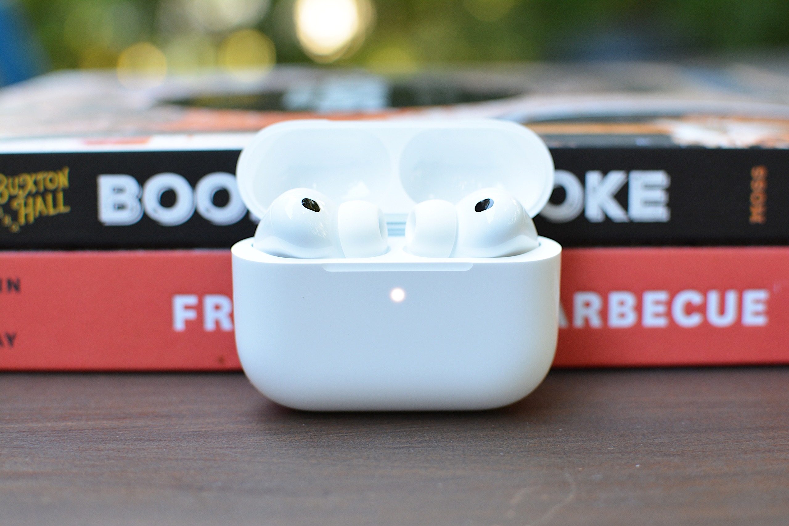

Before I get into the upgrades to the ANC system and the other tools that those unlock, I’d be remiss not to discuss how the overall redesign of the AirPods Pro 3 factors in. First, Apple adjusted the direction of the sound coming out of the earbuds so it’s going more directly into the ear canal. Next, the updates to the AirPods Pro 3’s fit — including the new foam-filled ear tips — create a better seal that helps make the ANC setup more efficient.
“The better fit allows us to diagnose what’s happening inside the ear canal,” Matthew Costello, vice president of audio and hardware engineering, explained. “We can actually make ANC more precise, compensate for leak and also better understand the geometry of the individual ear canals.”
Costello said that the product design team spent a lot of time on the new ear tips, arriving at a silicone-coated, foam-infused version for the AirPods Pro 3. He noted that these tips provide the best seal of any AirPods so far, which I can confirm, and that the passive noise isolation they provide is one aspect of the new-and-improved ANC performance.
In order to improve the ANC tech, the engineers employed something called headroom control so that Apple could get more feedback from the microphones in the noise-cancelling system. Those internal mics monitor any unwanted noise that sneaks into the ear canal and prompts the ANC setup to make the necessary changes. The team was then able to optimize performance using a combination of software, geometry and acoustics.
An inherent trait of foam ear tips is that they’re better at blocking higher-frequency sounds, which Costello describes as "more challenging," so I asked how much of the improvement in overall ANC performance was simply due to this new component. Costello was quick to clarify it’s one part of a much wider system.
“It's a significant contributor, but it's part of the overall system performance,” he continued. “The understanding of what's actually happening in the ear canal helps us diagnose when you need more ANC, but the better seal makes the whole experience more reliable.”
The acoustics engineers, which include a dedicated ANC team, also redesigned and repositioned the noise floor microphones. These are the components that detect any unwanted sounds from either the earbuds themselves or your environment. Since there’s now a more direct path into the ear canal, there’s less room for interference or distortion. A new self-tuning algorithm then takes the data from those mics and identifies exactly what’s going on inside of the ear. Again, it’s all in the name of precision.
“It's essentially a cleaner signal that's more predictable,” Treski explained.

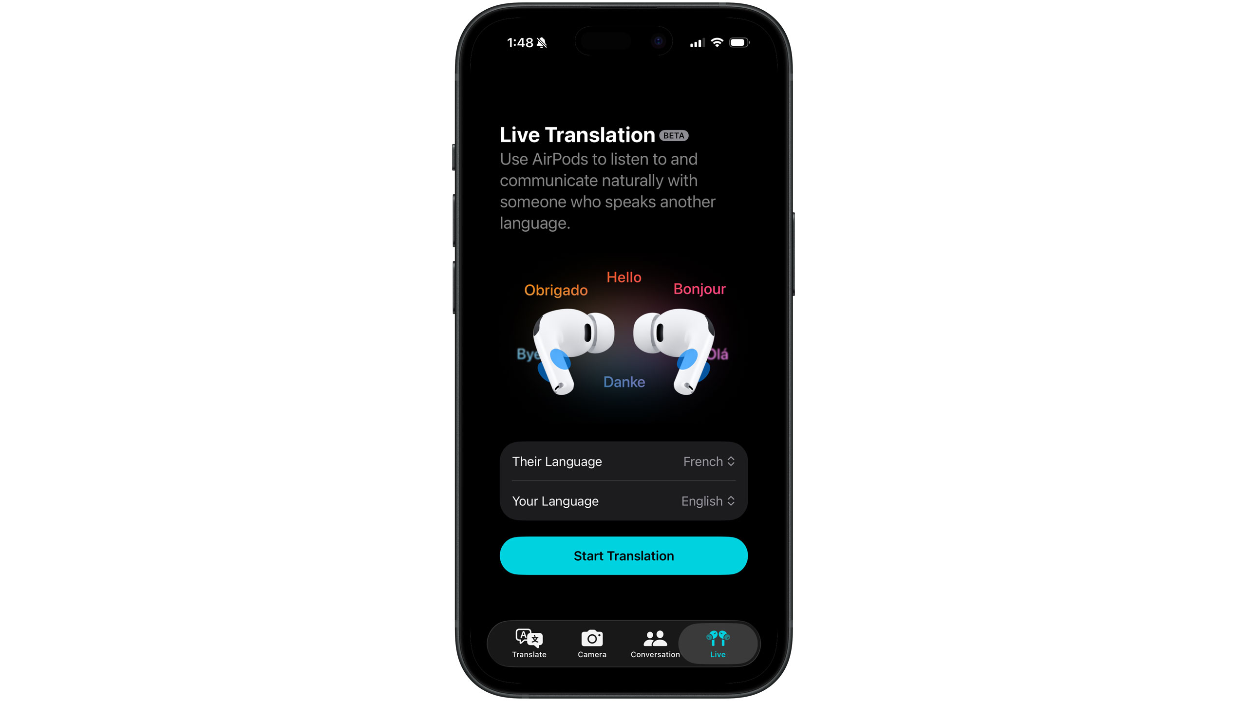

The most impressive part of Apple’s new Live Translation feature on the AirPods 4 with ANC, AirPods Pro 2 and AirPods Pro 3 isn’t the language conversion. For me, it’s the way active noise cancellation kicks in to ensure you can hear Siri speaking. When you begin a Live Translation session on a compatible set of AirPods, ANC lowers the volume of the person you’re speaking to and reduces environmental noise so that you don’t miss a word from Siri.
“We really wanted to ensure that you were able to hear Siri and have an understanding of the conversation in the best way possible,” Treski explained. “So, the idea is being able to really focus on that voice and not be distracted from other surrounding sounds.” Costello added that real-world testing, with careful attention to hide the unannounced products in public, is inherent to the development process.
