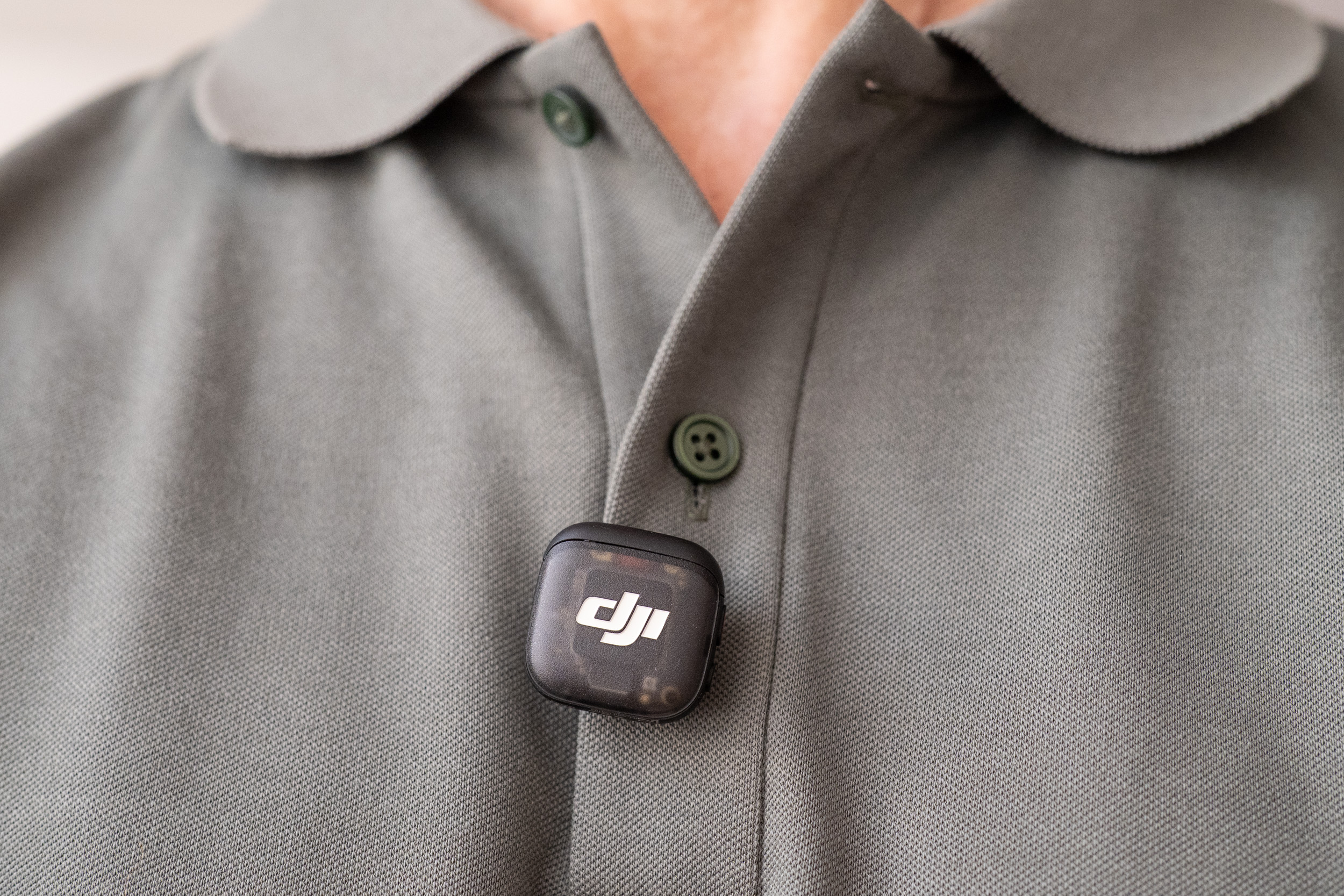

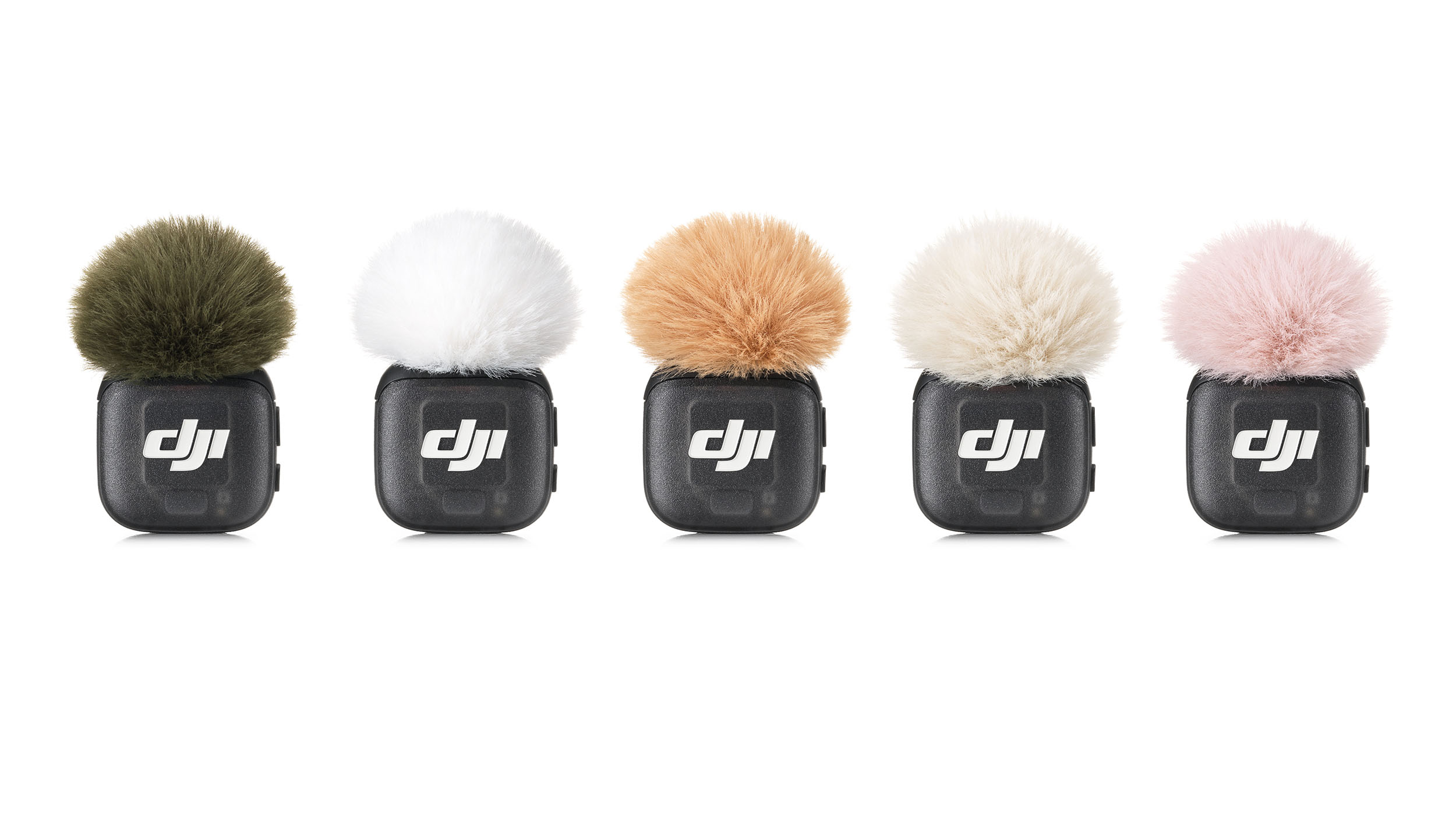

The most noticeable change with the Mic 3 is the smaller transmitter size and lighter weight. It weighs just 16 grams (.58 ounces) compared to 28 grams (.99 ounces) for the Mic 2, though it's bigger and heavier than the Mic Mini transmitter (10 grams). DJI has also improved the transmitter mounting options, introducing a rotating clip along with the magnetic option. There's even a choice of five colors for the windscreen to better match your subject's clothing.
The smaller size and rotating clip makes the Mic 3 more discreet and easier to attach to any shirt or hat. However, there's still a large "DJI" logo on both sides of the transmitter that looks ugly but gives the company free advertising, I suppose.
