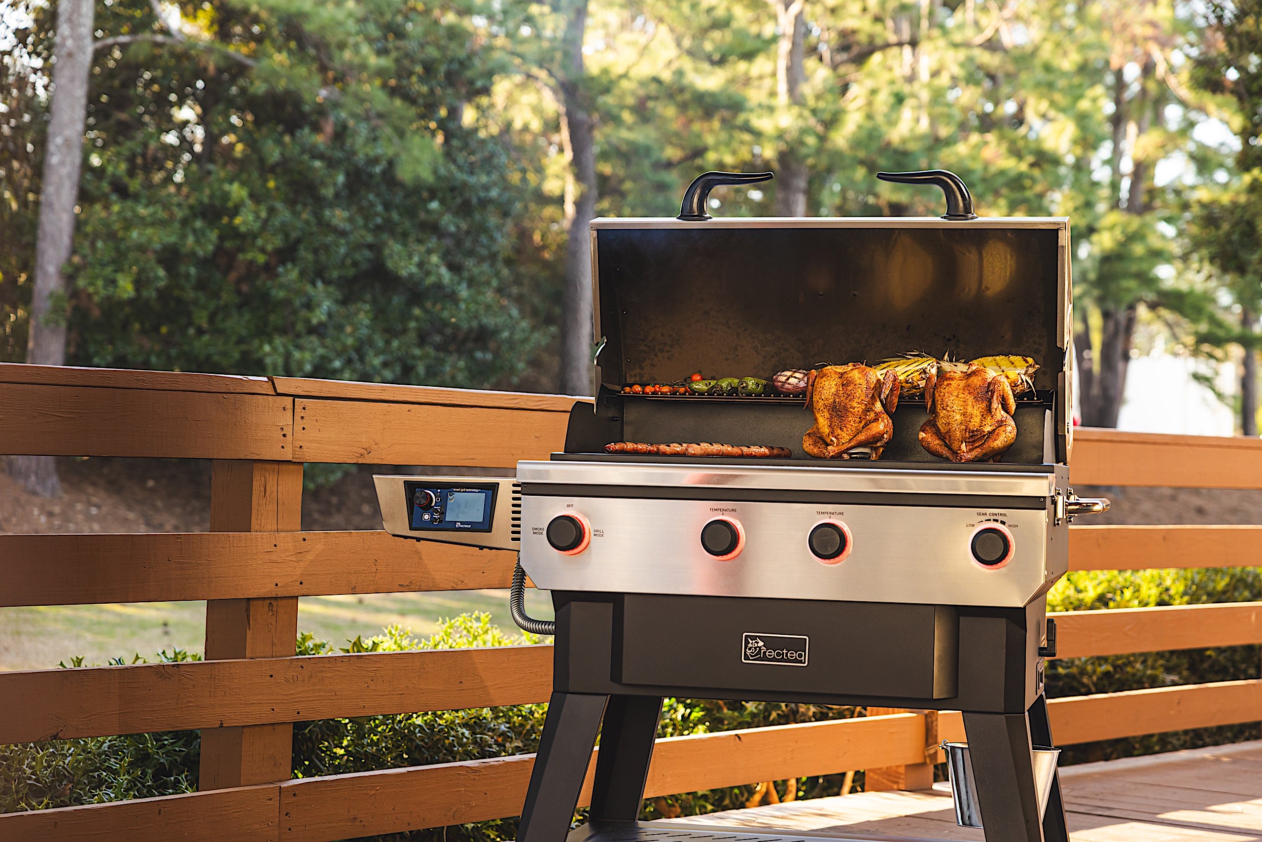

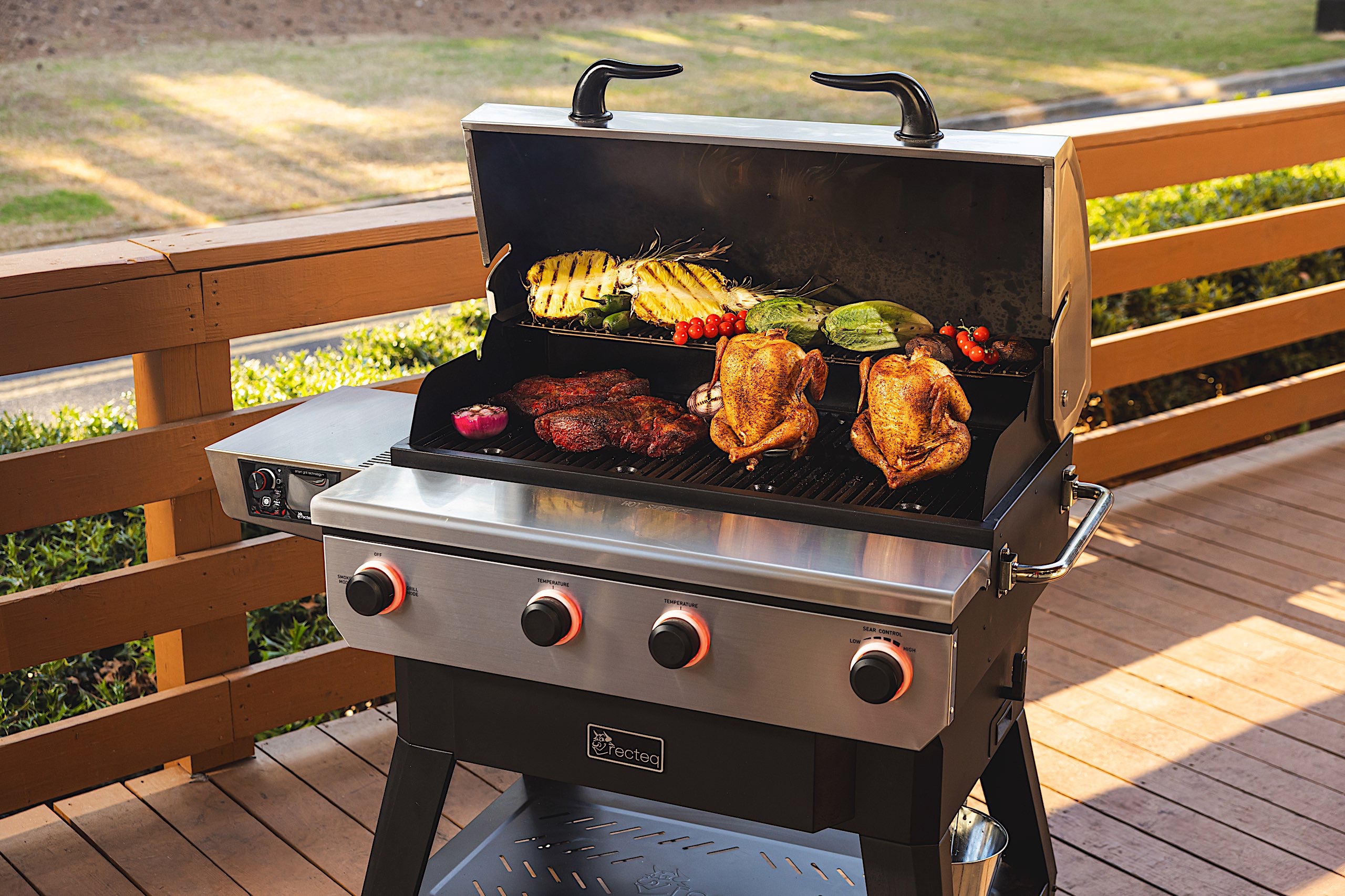

With the X-Fire Pro Recteq needed to create a similar two-burner/fire pot setup. Just one of those wouldn’t be enough to adequately cover the 825 square inches of cooking space on such a large grill. That’s especially true when there’s a direct heat option involved. However, the dual fire pots aren’t what’s necessary for the 1,250-degree performance. For that, the company utilizes the fire pots from its Bullseye Deluxe model that’s also capable of 1,000-degree searing.
Lesshafft walked me through how Recteq achieves this, employing a specially designed, “gasification-style” fire pot that ignites the wood gas that’s produced when the pellets burn. With a double-walled construction for this crucial component, something that works similarly to the airflow channels on a Solo Stove fire pit, the company can ignite that wood gas at temperatures above 500-600 degrees for “an accelerated amount of heat.”
Now that Recteq can reach an extreme amount of heat by fully exploiting the pellets, it needs to allow food to come in direct contact with the flames. “That’s the adjustable damper,” Lesshafft said. “You can go fully closed, partially open, almost all the way open and wide open.” The damper and an Adaptive Sear Control feature are only available on the right-side fire pot though.
On the left, there’s a perforated steel deflector covering the heat source. This allows for the hot and cold sides of the grill, or hot and not-so-hot, both of which are common cooking setups for gas grilling. You’ll need higher heat for searing a steak, but more indirect heat for bringing it fully to temperature. Or maybe you have people over who all like their steaks cooked differently. Either way, gas grills allow you to have varied heat zones and so does the X-Fire Pro’s Grill Mode.

For Smoke Mode on the X-Fire Pro, only the left fire pot runs. That perforated deflector I mentioned is designed in such a way that the heat is pushed towards the middle of the grill. It’s similar to how an offset smoker (stick burner) works. Even though the active fire pot is on the left side of the cooking chamber, “the temperature balance is remarkably stable,” Lesshafft noted.

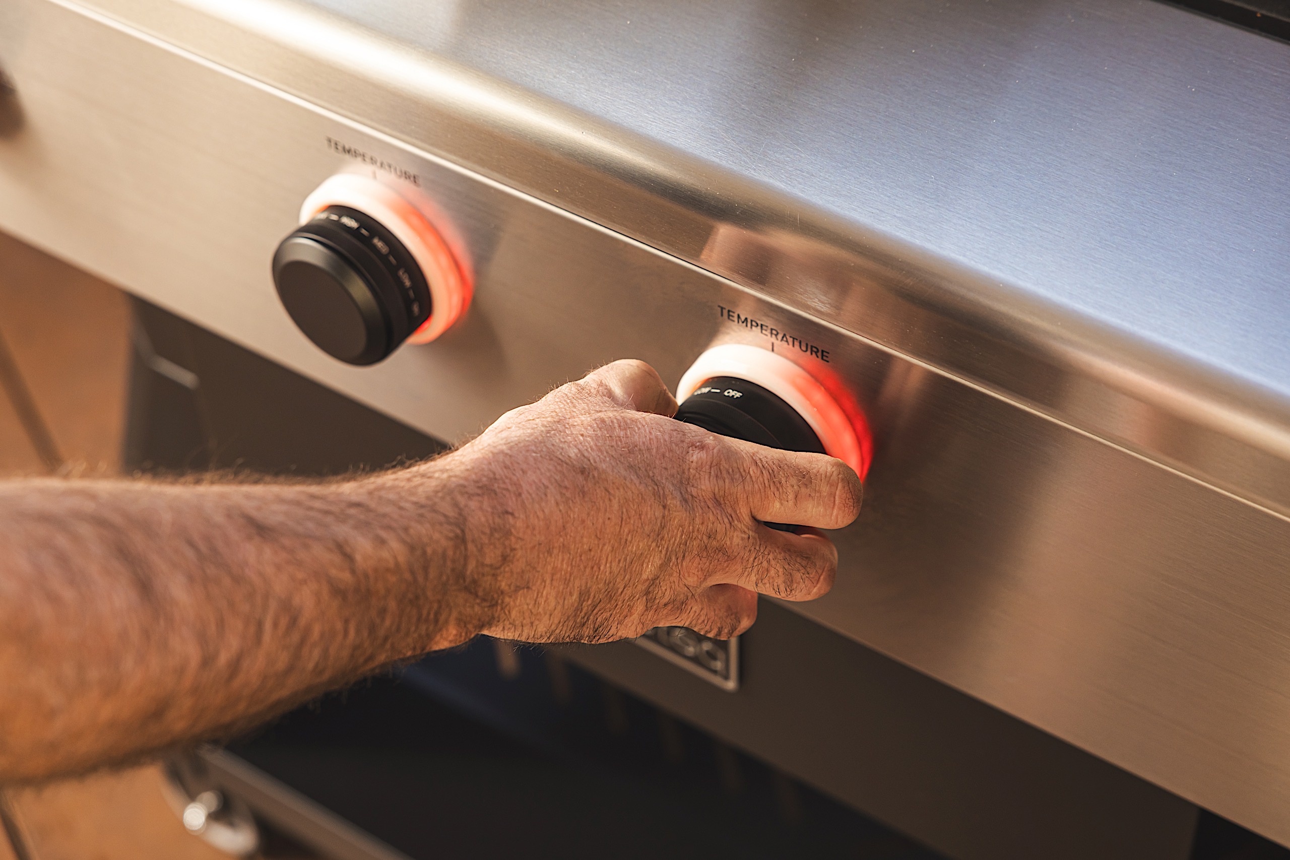

To completely synthesize the two types of grills into a single unit, Recteq also had to design controls that would be easy to understand for both gas and pellet grill users. “We wanted to create a lot of things that were familiar to the gas consumer,” he explained. “That’s the knobs on the front, a lot of stainless [steel], and even when you turn it on, that’s the LED rings around the lights.”
There are four knobs in total. The one on the left controls the two grill modes: Smoke and Grill. When you select the latter, all of the LEDs around those knobs light up red. There are two knobs for burner/fire pot control, allowing you to select low, medium, high or maximum. There’s also an Adaptive Sear Control knob which allows you to adjust how much direct flame is coming in contact with your food.
Recteq
When it’s time for Smoke Mode, turn that far left knob and the X-Fire Pro’s controls transform the machine into a traditional pellet grill. The LEDs around the four center knobs change from red to white, and the controller that’s mounted on the side shelf turns on. Here, you’ll adjust settings for those low-and-slow cooks and monitor temperatures. If you’re unfamiliar with pellet grilling, the controller’s display will help with tips like a reminder to keep the lid closed while smoking.
