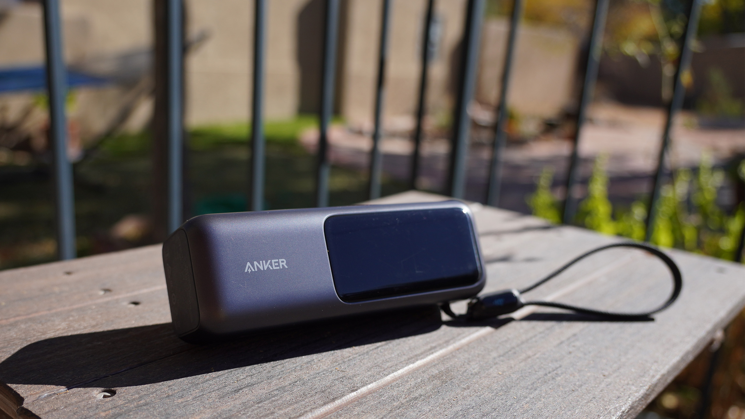

My only gripe with the design is that the very shiny screen has become slightly dull with use. It doesn’t look bad, just not as mint-fresh as when it was unboxed. That’s to be expected, and I’ll take the luxe finish over some ruggedized enclosure any day.

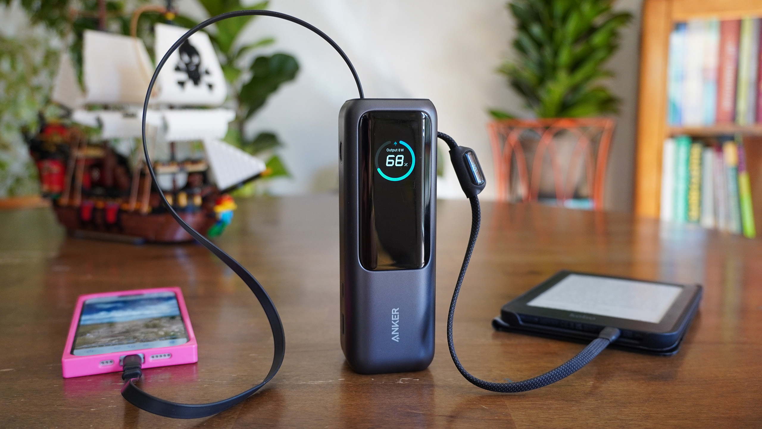

Two built-in cables and a big capacity let you charge two devices at once.

Possibly the power bank’s most useful features are the two built-in USB-C cables, and one even loops around to create a handy carry strap. It feels robust and well-anchored enough that I don’t fear lugging it around like that. The other cable retracts into the unit and extends up to two feet when needed. The end stays neatly tucked into a well in the body and stays magnetically in place. The cords not only look tidy, their inclusion means you’ll never find yourself in the ironic position of having a dead device and a full battery pack, but no way to connect the two.
Both cables serve in-out functions so you can easily plug them into any USB-C power adapter for a refill. There are also two additional USB (one Type-A and one Type-C) ports, so if you’ve got a specialized cable, such as Lightning, smartwatch or microUSB connector, you’ll be able to charge those devices too.
